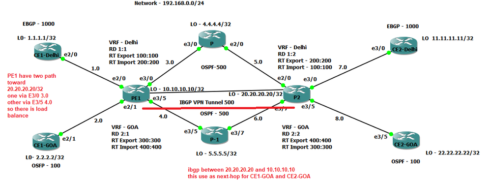

Hello Team,
need your help to understand the route selection when we using MPLS and inside the MPLS there is OSPF protocol. I am getting confuse when doing traceroute from CE1 to CE2 another site and it is taking the path which i am not understanding.
Please find my gns diagram.
in this attached topology all are working fine there is no issue. but below is my question.
when i am doing traceroute. from CE-1-GOA to CE-2-GOA Loopback ip address without source, it is taking other path but when using same traceroute with source it is taking another path. why here i am getting confused.
CE1-GOA#traceroute 22.22.22.22

CE1-GOA#traceroute 22.22.22.22 source lo0
Type escape sequence to abort.
Tracing the route to 22.22.22.22
VRF info: (vrf in name/id, vrf out name/id)
1 192.168.2.254 228 msec 132 msec 212 msec
2 192.168.3.1 [MPLS: Labels 16/22 Exp 0] 752 msec 788 msec 588 msec
3 192.168.8.254 [MPLS: Label 22 Exp 0] 532 msec 484 msec 524 msec
4 192.168.8.1 576 msec 632 msec 896 msec

PE1#show mpls forwarding-table
Local Outgoing Prefix Bytes Label Outgoing Next Hop
Label Label or Tunnel Id Switched interface
16 16 20.20.20.20/32 0 Et3/0 192.168.3.1
16 20.20.20.20/32 0 Et3/5 192.168.4.1
17 Pop Label 4.4.4.4/32 0 Et3/0 192.168.3.1
18 Pop Label 192.168.6.0/24 0 Et3/5 192.168.4.1
19 Pop Label 192.168.5.0/24 0 Et3/0 192.168.3.1
20 Pop Label 5.5.5.5/32 0 Et3/5 192.168.4.1

P2#show mpls forwarding-table
16 Pop Label 4.4.4.4/32 0 Et2/0 192.168.5.1
17 Pop Label 192.168.3.0/24 0 Et2/0 192.168.5.1
18 18 10.10.10.10/32 0 Et2/0 192.168.5.1
17 10.10.10.10/32 0 Et3/7 192.168.6.1
19 Pop Label 192.168.4.0/24 0 Et3/7 192.168.6.1
20 Pop Label 5.5.5.5/32 0 Et3/7 192.168.6.1
21 No Label 22.22.22.22/32[V] \
0 Et3/5 192.168.8.1
22 No Label 192.168.8.0/24[V] \
0 aggregate/GOA
23 No Label 11.11.11.11/32[V] \
0 Et3/0 192.168.7.1
P2#
MPLS use two path
to be sure shut the 3/0 interface in PE1 and check the traffic, it must pass via 3/5 for two cases

yes i shut the port e3/0 and now below are the output.
1 192.168.2.254 184 msec 104 msec 176 msec
2 192.168.4.1 [MPLS: Labels 16/21 Exp 0] 580 msec 624 msec 808 msec
3 192.168.8.254 [MPLS: Label 21 Exp 0] 716 msec 648 msec 364 msec
4 192.168.8.1 500 msec 560 msec 396 msec

but still same question load balance is fine it is happening.
but still confusion why when using source lo0 it is taking one path and without source lo0 it is taking another path to to understand this and clear my doubts.
see after turning on the e3/0 again same result.

if this is using lable that also same in both the cases. but with source using 3.1 and without source lo0 using 4.1 , this is not clear and how it is happening , how to verify this so that i can clear my doubts.
the hash my friend use in load balance effect the selection of path. hash use Source/destination IP and some time L4 port to select the path, here you change the source of traffic one time you use LO and other the router by default use the link between CE and PE as source and that effect link selection.
and for it is fine or not. sure it fine and healthy in network to load traffic between multi link (labels)
