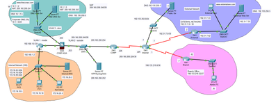

Hello Community,
I'm currently facing some difficulties in configuring routing within a network topology using Cisco Packet Tracer. I have attempted to use OSPF , but unfortunately, it doesn't seem to be working as expected. My professor has mentioned that I should try a hybrid routing approach, possibly involving OSPF and BGP . However, I have limited experience with this configuration method and would greatly appreciate some guidance.
Before diving into the specifics, here's a brief overview of the topology:
The problem arises when I attempt to access "www.theccnas.com" from the Admin PC. Additionally, I am unable to access "www.externalone.com" from the NET Admin PC and the DMZ Web Server. These issues seem to be related to routing, and I suspect that a combination of OSPF and BGP might be necessary to resolve them. It's worth mentioning that I have implemented some security measures, such as ACLs , within the network.

Hi
I took a look on your project and here is the first problem I have found.
The Admin PC has the DNS 192.168.135.250.5, however, if you go to DNS > Service It is blank. There is no entry there. You should have an entry like
Name www.theccnas.com Type A record and adresss. The address should be some HTTP server on you network.
The same situation I have found for Net Admin.
The routing I think is ok as I could ping the DNS server from the PC.
