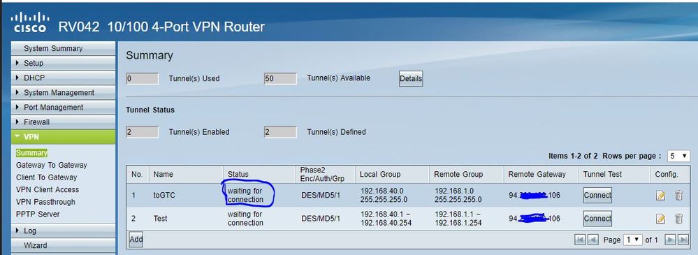

I have attached the View System log snap here and I am getting this message every time nothing is seeing like an error while trying to connect through Gateway to Gateway VPN.

I have checked and found it doesn't show any relevant logs, in the previous reply I have attached the snap so this time also showing the same.
We are accessing the internet separately in both sites but when trying to connect the Gateway top Gateway VPN connection that time I am getting the STATUS is Waiting for Connection.
