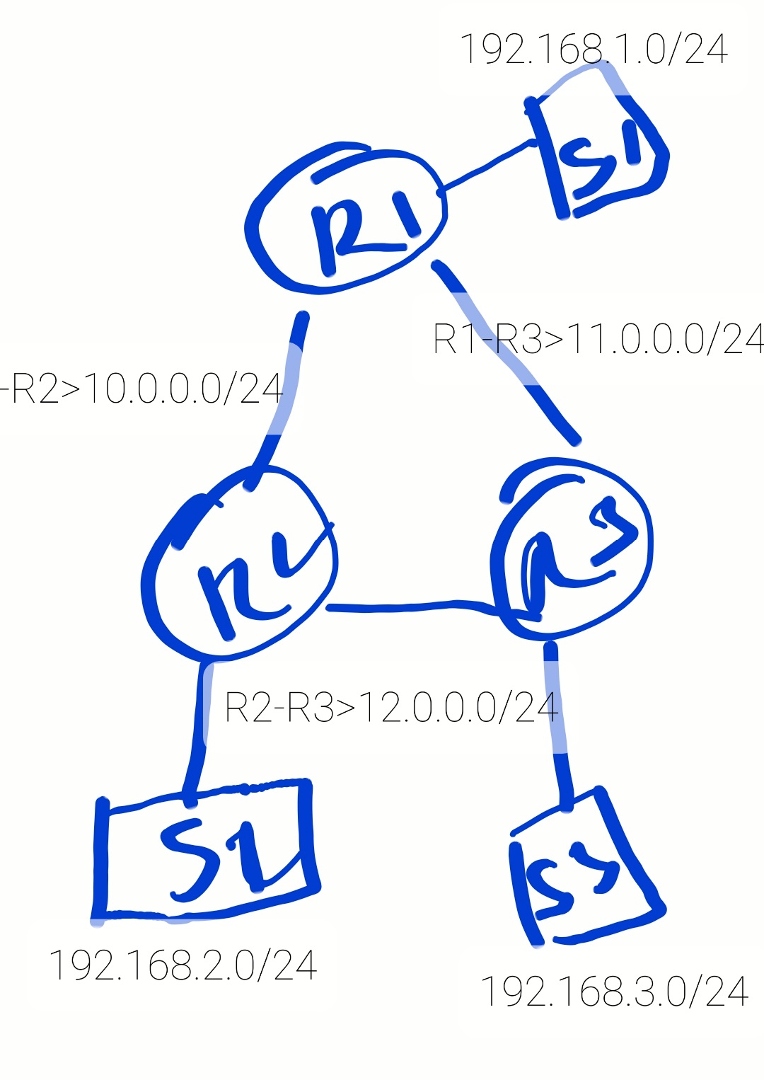

I am trying to configure ospf in network which consist three routers connecting each other.all routers are connected in same area through ethernet cable.
However it forming loop in packet tracer.
How can I avoid loop for my topology?
Is this fine to use ethernet cable for connecting routers?
Can anyone make it clear?
Thanks
Ranbir

04-27-2022 09:18 PM
Attaching the topology.plz have look.
Thanks
Ranbir

04-27-2022 09:21 PM
Hi Joseph,
Plz have look,attaching topology screenshot.
Thanks
Tinku

04-28-2022 06:57 AM
The only thing making loop here that you use same subnet in somewhere
between router
or subnet for PC connect to router.
please confirm that you use the right unique subnet in this design.

04-28-2022 07:09 AM
For some reason the forum wont let me respond to your drawing message.
Anyway. If those interfaces are configured like that and you have basic ospf configuration it should not form a loop.
Can you provide the information that you see where you determined you have a loop (i.e. logs, console messages, etc)
If no messages then can you provide the out put of: 'show ip protocols' command on each router?
