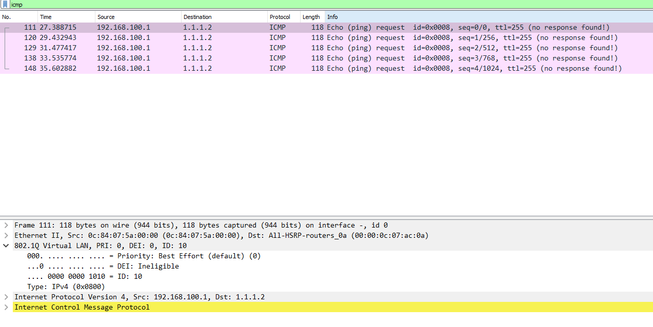

ok, capture the traffic before enter the R1,
do you see the frame tag with VLAN-ID 10 ??
share the wireshark frame
yes, vlanID 10
