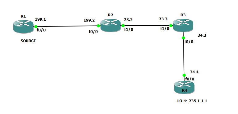

Scenario#1 PIM SPARSE MODE
Please consider the following design for PIM SPARSE MODE:
Source is not sending any STREAM at 235.1.1.1 at the moment, we can see (*,235.1.1.1) has been built at RP:
R3#show ip mroute
(*, 235.1.1.1), 00:02:20/00:03:07, RP 23.23.23.3, flags: S
Incoming interface: Null, RPF nbr 0.0.0.0
Outgoing interface list:
FastEthernet1/0, Forward/Sparse, 00:02:20/00:03:07
This is what i noticed:
1)FHR takes multicast packet received from SOURCE , (10.10.10.10 235.1.1.1and make two copies of the packet. It sends one in REGISTER MESSAGE, and the other natively i.e without any tunnel encapsulation towards RP.
Below Capture is taken between FHR and R2 to demonstrate Multicast Stream are transmitted in REGISTER Message and NATIVELY
1)Focusing only on this natively transmitted packet , why does FHR make copy and transmit the packet natively?
I mean, FHR can continue to transmit in REGISTER message only until it receives REGISTER STOP and (S,G) Join from down stream PIM router R2 .
I also noticed:
2) When PIM neighbor relationship establishes, PIM enabed router does not know if its neighbor is running SPARSE or DENSE mode, as I I do not see any such INFO communicated in PIM Hello.
Thoughts?
Have a nice weekend!!

I am using GNS3 so not sure what I am observing is normal or GNS3 bug.
I
) Upon reception of this Multicast traffic at the the PIM DR Router located in the same network segment (aka the FHR), this Router originates a PIM Register (Unicast packet) to the RP. This and sequent (if necessary) PIM Register packets include the original IP Multicast traffic as payload. At this exact point no Multicast traffic is natively forwarded by the FHR.
Not sure If this GNS3 bug or this is expected behavior.
I see FHR makes two copies, for each packet. as shown demonstrated below:
Below R2,R3,R4 are configured PIM SAPRSE -DENSE mode.
( *,235.1.1.1) has been built with RP as the root and Source ( 199.199.199.1) has not issued any STREAM yet
Current State of the Network:
R3#show ip mroute
(*, 235.1.1.1), 00:04:32/00:02:53, RP 23.23.23.3, flags: S
FastEthernet0/0, Forward/Sparse-Dense, 00:04:32/00:02:53
We issue one multicast packet from source 199.199.199.10 to 235.1.1.1
We issue single ping but get two respnse for same ICMP echo (Note " 0" next to request below)
R1#ping 235.1.1.1 repeat 1
Type escape sequence to abort.
Sending 1, 100-byte ICMP Echos to 235.1.1.1, timeout is 2 seconds:
Reply to request 0 from 4.4.4.4, 112 ms
Reply to request 0 from 4.4.4.4, 120 ms
On the capture between R2---R3, we see R2 ( FHR) makes two copies of the same packets, place one in REGISTER MESSAGE and the other is transmitted natively.
The reason we can say it is same packet is because Sequence number of ping is zero and we see two responses for the same sequence , same thing verified when we look at the capture below:
Note Register payload has the same original ping which is also sent natively right after REGISTER,
Note there is no Capture filter, we only see NATIVE packet right after REGISTER , we do not see any
( S,G) Join for ( 199.199.199.1, 235.1.1.1) and REGISTER STOP YET.
Note sequence number in ICMP ECHO. Below , I have expanded capture showing same ICMP ECHO sequence number, showing it is the same PING packet being transmitted natively:
Not sure if this is GNS3 bug or expected behavior:
4) Again, remember that in the previous step the RP sent a PIM Join towards the FHR. Upon reception of this PIM Join at the FHR is when the FHR starts sending the Multicast traffic natively and not before.
I see the only thing that stops FHR not to use REGISTER MESSAGE is PIM REGISTER STOP not PIM JOIIN ( S,G) alone.
Some thing that can be demonstrated by blocking REGISITER STOP MESSAGE by ACL so it never reach FHR.
(S,G) treee will be built between Rp and FHR and eventually between LHR anf FHR , but FHR contiue to send REGISTER and NATIVE PACKET on S,G tree.
Same behavior i.e payload is copied in REGISTER and Transmitted natively by FHR,was observed when R2 is PIM DENSE with RP configured:
REGISTER PAYLOAD:
NATIVE:
Much appreciated!!!
Thanks for all the help, have a nice evening!!

Below are the config, now I see the behavior you mentioned: FHR sends packet in REGISTER only, I do not see NATIVELY Transmitted packet right after REGISTER. But earlier in screenshot posted before, we see FHR sends REGISTER and right after that NATIVELY TRANSMITTED packet. This is the behavior which led me to post this question so I can find what is expected behavior or what is not.

Hi, sarahr202!
RP was on R3 in topic starting post. And you posted configs for modified network with RP on R2.
However, with posted configs, RP on R2 and testing client on R3 all should be fine. Do you still see duplicating starting packet?
