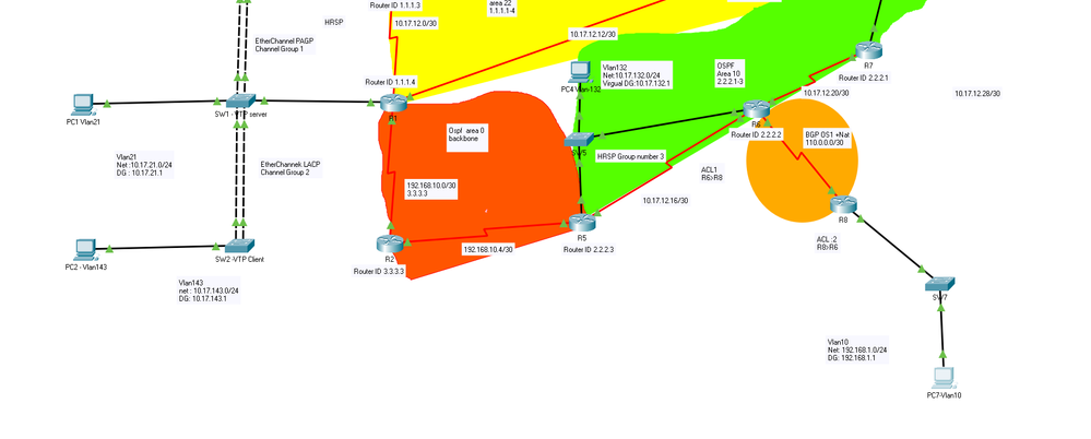

Problem with getting Out of the BGP
StolenSkills
I made this topology,
The network of R8 can ping to the outside routers,
but it Cannot get a IP address via DHCP server
or get out to the other devices via SSH,
file and picture is attached
-user name Project
-Password is 1234
not sure if this is a limitation in Packet Tracer, but the multiple 'ip nat inside' on the serial links does not seem to work. The DHCP works if you leave the 'ip nat outside' on the link between R6 and R8. In addition, you need to set the start IP address for the 192.168.1.0/24 network in your DHCP pool to 192.168.1.2 (it is now 192.168.1.0).
