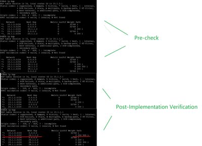

Hi @woogx ,
The goal is to announce the aggregate route from R2 to R1 and R4. Since R3 and R4 are
> rejecting the routes after the aggregation (please see the pre-check result)
We can see the aggregate (10.1.0.0/22) on R4 and not on R3 in the post implementation verification. So the solution provided by @David Ruess is the right one and complies with the requirements.
Regards,
Regards,
