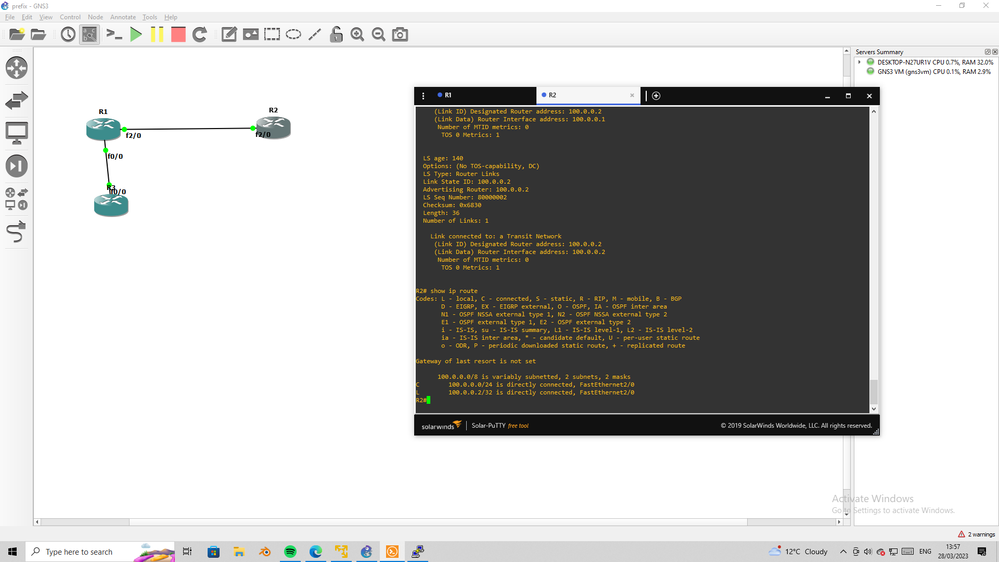

Oh I see, thanks! So the filter list does not apply for Type 1 & 2 LSAs, hence the 192.168.234.0 routes were still being learnt in the RIB. The only way is to use distribute-list filtering to perform the filtering.
you can not use filter in this case since both router in same area and the OSPF prefix is LSA1/2
you want to filter this prefix ??
this way in OSPF you can filter the LSA1/2 (intra-area) from inject into RIB
BUT BUT
I dont prefer it as also cisco recommend,
you see the route (10.0.0.0/24) disappear from RIB of R2 but appear in OSPF db
this can lead to some blackhole in real network
use it carefully
Screenshot (466).pngScreenshot (467).pngScreenshot (468).pngScreenshot (469).png

there are two table
OSPF database show ip ospf database router or network
RIB (which router use for forwarding packet) show ip route
distribute-list  not effect OSPF DB (NOT DELETE LSA FROM DB) it effect remove the ROUTE from RIB
please check my lab again I mention that the route in OSPF DB but it missing from RIB
