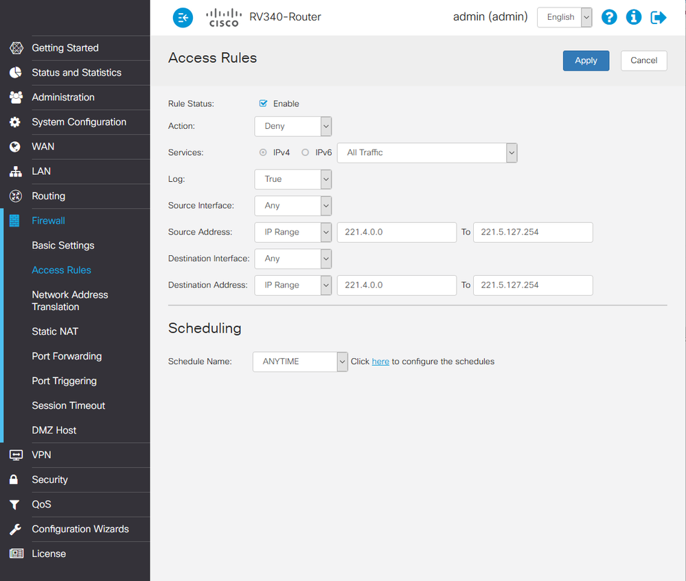

Regarding RV340 router configuration - Firewall - Access Rules, I have questions hopefully someone can answer.
The terrible, inadequate manual, does not ever explain functional behavior of the router, it just repeats what is in the UI.
in the example screenshot below, I have set a rule that is expected to block a range of IP addresses in China.
Will the rule as in this example,  function properly to block any access to/from the the IP range?
Does the Source, Destination behave as an AND function so that both conditions must be met?
Does the Source, Destination behave as an OR function so that either of the conditions may be met?
Testing is inconclusive so i have turned to this forum as a resource that hopefully knows about this.

the screenshot is missing...
Either way, the firewall rules should work as source AND destination, similar to access lists.
What do you mean when you say testing is inconclusive ?

Follow up testing on Firewall Access Rules.
Access rules do not function as expected by blocking websites on specific IP ranges.
I have now tested blocking the same range (221.4.0.0 - 221.5.127.254) on both source and destination in the same rule as in the first message.
I have now applied and tested separate access rules blocking the IP range 221.4.0.0 - 221.5.127.254
I then access a webpage www.bendss.com  which is at 221.4.168.69.
It should be blocked by the router firewall access rules and it is not.
I have been careful to clear all browser caches and flushed local DNS cache as well.
Why do firewall access rules not function at all? What is the problem????
Please see the attached screenshots:
RV340 Firewall Access Rules Behavior - SourceBlock.pngRV340 Firewall Access Rules Behavior - DesinationBlock.png

Either way, since you have logging turned on, is any traffic corresponding to the firewall rule logged at all ?
That is odd. Ping does return that address in the 129 range not the 221 range.
My sources were
https://www.pagesinventory.com/ip-subnet/
and
https://www.pagesinventory.com/ip/221.4.168.69.html
https://www.pagesinventory.com/domain/www.bendss.com.html
and interestingly DNSlytics also shows that bendss.com is at 221.4.168.69
https://dnslytics.com/ip/129.226.99.198
Clearly the bendss.com website is redirected to - s14.zhanh.com [129.226.99.198]
I will test further and check router logs as well as OpenDNS logs. Would however prefer that the DNS requests are never forwarded from the router al all.
Thanks again,
mdd
I think content filtering might work better, as that allows you to block a URL rather than an IP address (range). Check the link below:
https://www.cisco.com/c/en/us/support/docs/smb/routers/cisco-rv-series-small-business-routers/smb5379-configure-content-filtering-on-the-rv34x-series-router.html
Actually, no, the need is to block a range of country IP addresses. so that suggestion is untenable.
Thanks tho.
mdd
so, can you block the 129 address then ?
