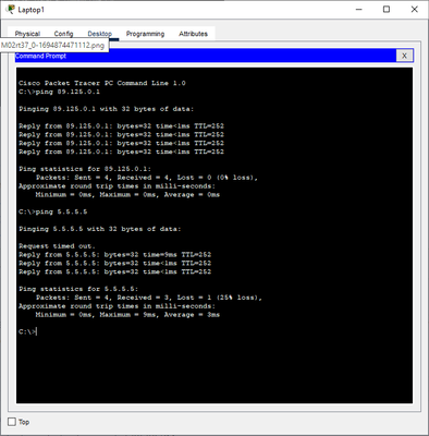

On R4, add interface loopback 0 with
ip address 5.5.5.5/32
Also always on R4, on router RIP instance add
redistribute connected
command.
After, that you will be able to
ping 5.5.5.5
from PCs:

Thank you very much for your help! I did everything you suggested and it worked perfectly!

Having a host actually at
5.5.5.5
to ping is a requirement, so that's well done by adding a loopback interface on R4 with that address, as suggested.
However, unclear why you also need to add
 command on R4.  I don't believe it's needed, and just a moment ago, opened the PT file, added the loopback interface with an IP of
5.5.5.5
and was able to ping that IP from laptop1.
