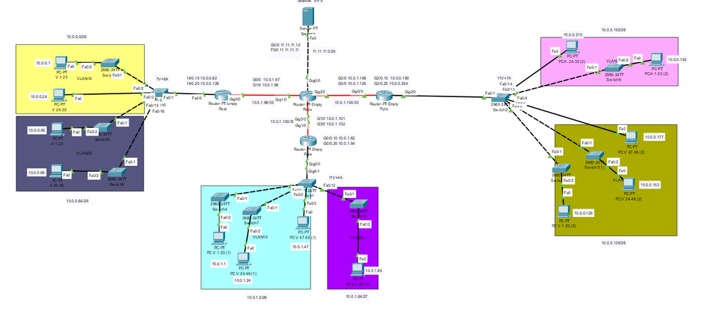

So  I always had hard time understand NAT, but this is weird. How I imagine there shouldn't be any difference from which VLAN I try to connect, but the "Public" Vlan 10 successfully reaches webserver, while "Admin" Vlan 20 does not. Any help?

The running-config I provided was for a router that is directly connected to the web server ( 11.11.11.11 ), VLAN's are defined on different routers. Vlan 10 are public ones, they can't have access to Vlan 20, while Vlan 20 are allowed full access to everything. Also Vlan 10 is using PAT and Vlan 20 isn't. The whole network looks like this:Screenshot 2021-12-10 170111.png

Every PC, no matter NAT or Vlan should be able to reach web server via HTTP/HTTPS, anything else should be blocked and Web server IP ( 11.11.11.11 ) should be natted when data is being sent "outside"
