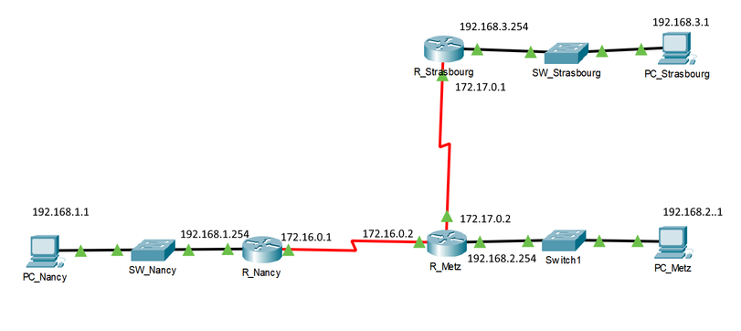

Hello community !
I just passed my networking essential and i'm trying to resolve my previous practical works to mastering routing concept.
The plan is:
Nancy shouldn't communicate with strasbourg, so i am using an Static route
I configure for now 2 routes, Metz and Strasbourg before to test them and to configure more devices:
R_Metz
ip route 192.168.3.0 255.255.255.0 172.17.0.1
show ip route
C 172.16.0.0/16 is directly connected, Serial0/0/0
C 172.17.0.0/16 is directly connected, Serial0/0/1
C 192.168.2.0/24 is directly connected, FastEthernet0/0
S 192.168.3.0/24 [1/0] via 172.17.0.1
R_Strasbourg
ip route 192.168.2.0 255.255.255.0 172.17.0.2
Show ip route
S 192.168.2.0/24 [1/0] via 172.17.0.2
C 192.168.3.0/24 is directly connected, FastEthernet0/0
I can't ping the 2 PC set up.
Why ? i can't explain. But it's a troubleshooting that my pratical work give without the solution.
Could you say to me what's next ?
Thank you !
most of the required static routes were missing. Your PCs did not have a default gateway configured. Find attached the revised file with end-to-end connectivity (this was saved in PT version 7.3).
4 Replies 4
post the zipped Packet Tracer project (.pkt) file.
The file
Okay you right for the default gateway thank you, it was the problem !!
For the static routes it was normal i just tested strasbourg-metz and did not configured the other routes
PS: you made a route for Strasbourg to Nancy and as i said in my exercice they shouldn't communicate
Thank you again for the correction it helps me a lot.
