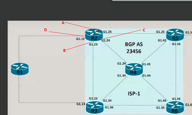

I have learned how to create subinterfaces on a router for inter-VLAN routing purposes. Recently, I have noticed that routers can be connected to other routers using subinterfaces. Can somebody explain how to do that? Please find below the network topology with sub interfaces  for reference.

I believe you are confusing subinterfaces with Interfaces. On the print you shared, Each router connection is one interface. So, look the note I did, A,B,C and D are different interfaces. So, you can not have
G.1.XX surrounding
the router like that.
Gi1/x
is the physical interface. It connect this router to another Router, right? You can only have subinterface with
G1.XX
between those 2 routers.  You can not have
Gi1.XX
connecting multiples Routers.
 Between R2 and R2, the interface is different and you need to change the subinterface accordingly.

But I have configured the sub interfaces in each Routers.Then I shutdown the Routers and tried to connect using Physical interfaces.But I couldn't do like below topology where they have used G1 based sub interfaces for almost all the routers.
G.1.XX surrounding
Gi1/x
G1.XX
Gi1.XX
