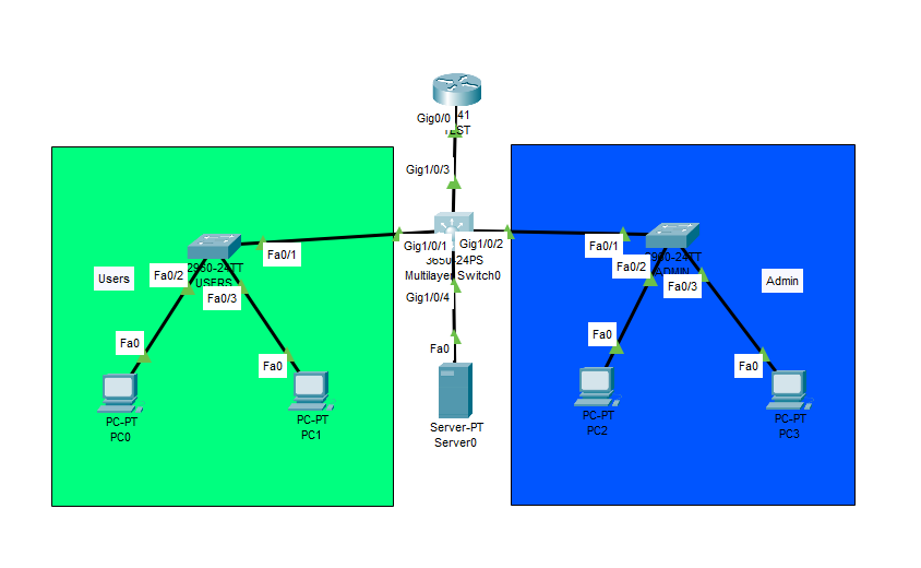

Hi all,
I've been working on a lab project and have gotten most of my configuration done but have run into two separate issues on my multi-layer switch that I've been stuck on.
The first issue involves OSPF, it works just fine once configured, however, once you close and re-open the packet tracer file the multi-layer switch forgets the routing commands for VLANs 10,20,and 30 (ip ospf 1 area 1) and they need to be re-configured each time the packet tracer file is opened and closed. I've saved the running configuration to the start-up configuration on the multi-layer switch but that doesn't seem to save. Is this a packet tracer bug? Or am I possibly missing a command?
The second issue is enabling TACACS on the multi-layer switch. From my reading and what I've seen online it seems like it's set-up on the multi-layer switch exactly like it is on the router however once configured it tells me even the local username and password that is setup through commands is invalid. This configuration works fine on the router however and I'll include it below:
Router TACACS
en
conf t
aaa new-model
username cisco password cisco
aaa authentication login default group tacacs+ local
aaa authorization exec default group tacacs+
tacacs-server host 10.210.83.67
tacacs-server key 1234
line vty 0 4
login authentication default
end
Here's the running config for my multi-layer switch as well in case the issue is being caused by my prior setup work:
ammahend
for problem 1 :  I don't know if this is a bug but try configuring ospf in config mode instead of under interface, it should save on closing PT and work.
for problem 2 : Open the sample tacacs Lab and make sure your TACACS service config is correct, you won't be able to login with local credential since line is not set for login local anymore.
-hope this helps-
