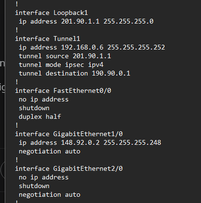

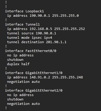

I'm trying to configure a VPN between R8 and R10 (cisco c7200 routers) at GNS3 in the image below:
But before that I've configured a tunnel between R8 and 10. I've inserted the mode, source and destination to both side's tunnel 1 interface. But even after doing so, the tunnel protocol stays down even when the status is up.
Startup config for R8:
Startup config for R9:
Startup config for R10:
All the other configs are the same as the default settings
Anyone might know the cause? Please advise
Thank you
If there are any additional information you would like to know do inform me, I will add them on here
@ss571
add static routes on R8 R9 and R10.
R8: ip route 201.90.1.1 255.255.255.255 148.91.0.3
R9: ip route 190.90.0.1 255.255.255.255 148.91.0.2
ip route 201.90.1.1 255.255.255.255 148.92.0.2
R10: ip route 190.90.0.1 255.255.255.255 148.92.0.3
Best regards

Only config static route for LO in three routers
The LO is not reachable and router use it as tunnel source
MHM
Meaning need to set static route with null0 in R8 and R10?
No ypu need static route for lo
As following
R8
R9
R10
Two static route in R9 for both Lo of R8 and R10
MHM

Hello @ss571
From R8 do you ping 201.90.1.1 with source 190.90.0.1 ?
Best regards
So far they can't ping each other, when i tried to ping R8 to R9's G2/0 they cant ping as well
@ss571
Best regards
Ok, I've added these routes in, should R8 be able to ping R9's int g2/0?
No these static route make tunnel up/up
Then you can ping from R8 to R10 using tunnel IP (you need to specify source in ping command and it must be tunnel ip)
MHM
