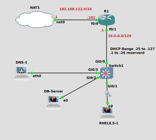

two interfaces from same router cant ping each other
janbaztaimoor
Here is my setup
here is the output of `sh run` command on my router

Interface f0/1 10.0.0.1 can ping 192.168.122.101
R1#ping 192.168.122.101 source f0/1
Type escape sequence to abort.
Sending 5, 100-byte ICMP Echos to 192.168.122.101, timeout is 2 seconds:
Packet sent with a source address of 10.0.0.1
Success rate is 100 percent (5/5), round-trip min/avg/max = 1/2/8 ms
R1#
but it cant ping 192.168.122.1
R1#ping 192.168.122.1 source f0/1
Sending 5, 100-byte ICMP Echos to 192.168.122.1, timeout is 2 seconds:
Success rate is 0 percent (0/5)
if you check the running config, default route is configured but its not working.
Also OSPF is configured but that dosent seem to work.
Any Ideas please.
This NAT cloud know the path to 10.0.0.0?
No it only know direct connection between it and router' any prefix behind router dont known by cloud
That why we need NAT
MHM
7 Replies 7
Without NAT in router this not work
MHM
explain that solution a little bit please
 access-list 10 permit ip 10.0.0.0 0.0.0.255
Ip nat inside source list 10 interface f0/0 overload
Interface f0/0
Ip nat outside
Interface f0/1
Ip nat inside
MHM
I am a new student of CCNA so I need to understand why it's not working and why this solution should work.
If you can point me to some documents that clear this specific solution, It will be really helpful.
MHM
I think the ip default gateway command might be the problem. Try and remove that (no ip default-gateway)...
Wizard4777
default route won't work because there is no nat in the config. configure ACL and NAT
