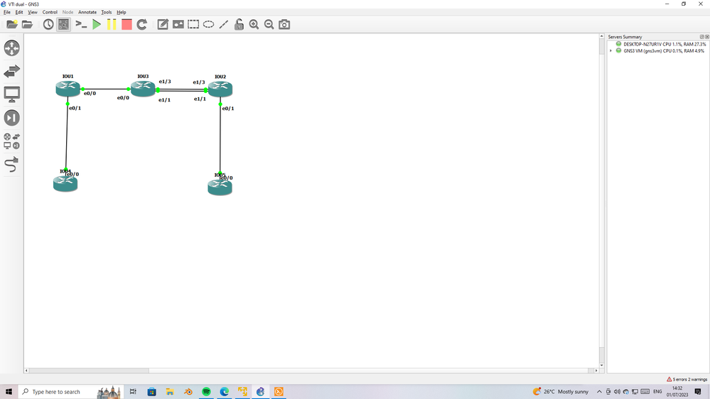

The above picture depicts simple topology which i have explained.peer a is fixed which is our side. Other peer will be either b or c in the same device. According to they change b to c we have to auto failover.. Can you help me with a sample config if this is possible with dvti. That will help. Or if any other simple way which you can suggest to make this failover smoothly without any manual interaction
Sure I will run lab and test some idea
