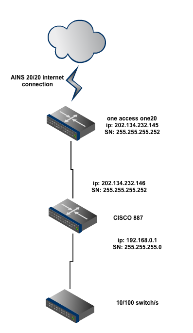

I am trying to set up an 887 to use fe0 as a WAN port to connect to another router that was provided preconfigured by my ISP (and i have no access to change settings on it)
i am able to connect to the one20 router (from the ISP) and out to the internet using a laptop plugged to its fe0 and using ip: 202.134.232.146, sn:255.255.255.252, gateway: 202.134.232.145. so it is working fine.
My problem comes when trying to set up the 887 to route it all.
Here is a quick little network diagram of what i am trying to do...
http://i29.photobucket.com/albums/c287/xacoupe/EMC.png
here is where i have gotten to with the config. In this state i can ping 202.134.232.146, but not 145 (the one20) and not out to the internet.... WHAT AM I DOING WRONG?!?

ok it looks like there is not traffic hitting the NAT ACL
when you connect to the router is you PC obtain IP address with the right IP range and Default gateway ?
are you using crossover cable between the two routers ?
it seems to be connectivity issue
Internet  202.134.232.145         0   Incomplete      ARPA
I was under the impression that network devices nowdays generally worked the difference between straight through and crossovers?
Yeah clients get IP addresses, subnet masks and gateways just fine.
yes the correct, but sometimes just it dose not work as epected, i am not sure if this is the reason but just give it a go
tried a crossover, still the same "incomplete" on the ARP list.
