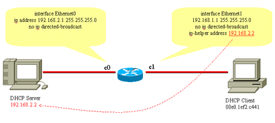

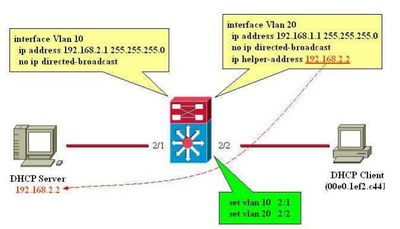

If you have decided that DHCP SERVER will be a windows server Then:
1. on router -
make sure that there is network connectivity between the windows server and the router (usually the default gateway of the users. e1/interface vlan 20 in the examples below)
2. on router -
Set ip helper-address <DHCP SERVER IP> in interface which will be used as the default gateway of the USERS

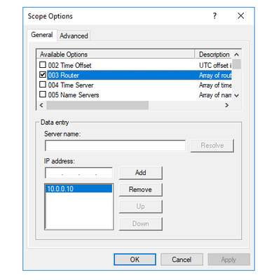

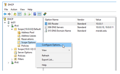

3. on DHCP Server -
under the DHCP scope set option=3 with ip address of the router (e1,interface vlan 20 in example below)
Example router configuration:
Example 2  router configuration:
1. on router -
2. on router -
3. on DHCP Server -
Example DHCP server option 3:
