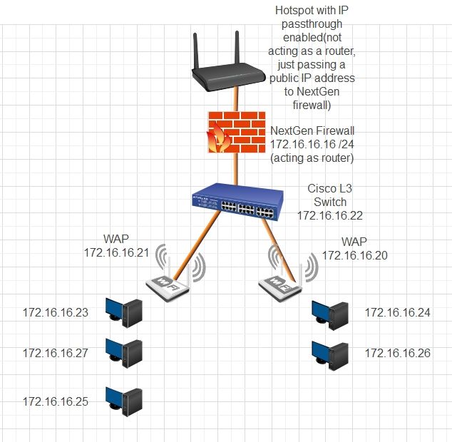

I am still having an issue with no internet when I assign a port to their respective VLANs. As soon as I assign the second port to the second VLAN there is no internet. I can ping inside and outside of the network on the switch. But the WAPs attached to GE1 and GE2 lose internet. I should also add that DHCP for the two VLANs shows as static. Here is my running-config and network topology.

I am not clear what is going on here. The first thing I notice is that the addressing used in your diagram does not match the addressing shown in your posted config.
I am also not clear about the symptoms you describe. Are you saying that if you bring up a single port that it does have Internet access and when you bring up a second port then neither host has Internet access?

I apologize, this is the correct network topology. The hotspot is not acting as a router. It is only passing a public IP address to the Next Generation firewall using IP passthrough.
How do I subnet this address into two networks?
172.16.16.0 /24
