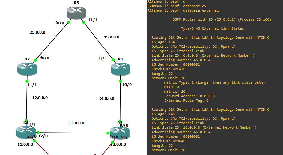

Hi Team:
The top half is running OSPF, and the down half is running RIPv2 +  EIGRP.
R1 advertise 11.1.1.0 with RIPv2, R3 advertise 33.3.3.0 with EIGRP.
Then I redistribute both RIPv2 and EIGRP into OSPF in R2 and R4. no other setting on redistribute, which means all the routes will be O E2 type and Metric 20 int end router.
Finally I get route table from R5, something makes me confused that the routes to 33.3.3.0 formed ECMP but not for 11.1.1.0.  Routes to 11.1.1.0 always keep one either 25.1.1.2 or 45.1.1.4, the route type and metric are all same, but why no ECMP in 11.1.1.0?
I attach the topo and config here, could someone help to explain?

eigrp we see equal because AD is 90 and OSPF is 110 so 90 is lower
for rip the ad is 120 and ospf is 110 and hence the issue appear.

did you manipulate the interface cost ? As far as I can tell, the 'problem' is that there actually IS equal cost load balancing to 33.3.3.0, as there is an additional router in the path that should make the cost higher. Can you post the output of:
sh ip ospf interface Gi0/0 | in Cost
sh ip ospf interface Gi0/1 | in Cost
from both the R2 and R4 routers ?

Hello
Prior to redistribution both ASBR R2/R4 will prefer the eigrp routes over rip so it’s basically down how they are seeing the loopback interfaces of R1/R3 Plus by default post redistribution as no specific metric is being defined ospf will append a default external cost of 20 to any external route also by default these external routes are costed as type E2 as such the internal cost to the ASBR (R2-R4) isn’t calculated, And looking at you configuration the difference is the way you are advertising the R1/R3 loopbacks:
R1 loopback0  is being advertised via RIP then redistributed
R3 loopback0  is being advertised via eigrp then redistributed

I return to home run small lab
remember I dont like idea of run two protocol in one link
so I delete the EIGRP
Now return to your issue
I see the same issue
R5 only add one path to prefix advertise,
I make some analysis and I found the issue
the R5 select the path through R4 (45.0.0.4) and advertise to R2
here the issue
OSPF have AD 110
RIP have 120
so the R2 prefer the path through ospf (via R5) not through direct connect R1.
solution
change the AD of OSPF be more than 120.

As per OP there is no path cost manipulation so from R5 perspective as it stands the redistribution is default E2 and the internal ospf calculation to either ASBR isn’t included also the redistributed rip/eigrp processes into ospf are default so the default costing will be 20.
as stated rtr1 loopback is via rip and rtr 3 is via eigrp - both asbr are eigrp aware so eigrp WILL take preference prior to redistribution into ospf hence i believe why the OP sees ecmp for r3 loopback 0 and not rtr 1 loopback 0
That's true. I also noticed that.
In database of R5, there is only one route to RIP destination.
Is it just like that R5 told R2, I have better OSPF path(lower AD) to RIP destination, so R2 compare the path with local RIP path, then select OSPF path and not advertise RIP path to R5 anymore.
correct - as stated previous  ASBR R2/R4 areboth eigrp aware so will prefer the eigrp routes over rip prior to redistribution, into ospf via E2 lsa.( equal cost of 20)
