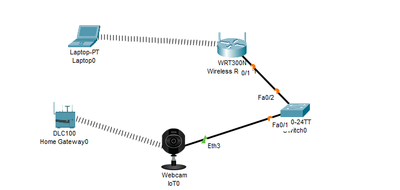

ramadasaid0204
Hi
I think you need to use a Home Gateway or connected with a Switch as you can see the Photo I'm attaching to the replay.
My Best Regards
