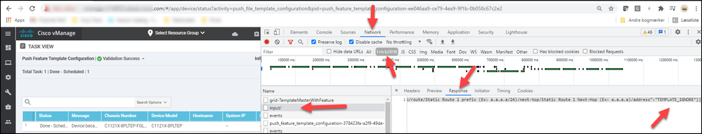

I found the solution - and the magic keyword is "TEMPLATE_IGNORE"
I accessed vManage using Google Chrome and turned on the inspector window.
It appears that the entire vManage GUI is actually doing all its stuff using the API behind the scenes.
I tried to attach the Device Template while monitoring the inspector, and captured the following:
After adding this to the body of my API POST - no errors in vManage and the template was successfully added
If you have an Optional config in the template you’re trying to attach using the API:
  • The config line MUST be in the body of your POST - even though it is optional - otherwise vManage will fail attaching the template
  • And the value must be either the correct value, or “TEMPLATE_IGNORE” if you don’t want to configure the specific optional config

Pixelweb
Hope this helps
Regards
Jeppe
