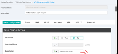

After pushing the template :
praveen-CCNP
edge-1#
vpn 0
name "Infrastructure VPN"
router
ospf
timers spf 200 1000 10000
area 0
interface ge0/0
network point-to-point
exit
exit
interface ge0/0
description "towards core router"
ip address 10.1.1.2/30
tunnel-interface
encapsulation ipsec
color mpls
no allow-service bgp
allow-service dhcp
allow-service dns
allow-service icmp
allow-service sshd
allow-service netconf
allow-service ntp
allow-service ospf
allow-service stun
allow-service https
no shutdown
ip route 0.0.0.0/0 10.1.1.1
praveen-CCNP
After few minutes it roll backs to old config: ( i have static route to vmange for sure before and after the config push using template)

Let make double check
MHM
Now it little clear
There is feature rollback timer
Which make vedge check vmange connect after template of vpn0 if it break connect it rollback to old config.
MHM
praveen-CCNP
1.
2. I am not using for service VPN , it is being used for OOB and I did not configure IP for it
vpn 512
name OOB-mgmt
interface eth0
description OOB-mgmt
ip dhcp-client
no shutdown
