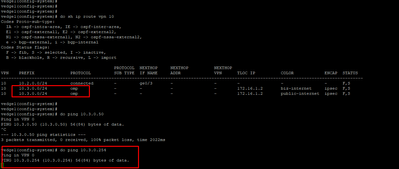

Here is the problem below, I do not seem to be able to ping any interface off my LAn interface
Literally drops at the edge
Also, VPN0 routes table not showing omp routes
vpn10 showing omp routes but cannot ping
When you ping it goes via VPN0 (global table in cEdge).
You should mention service VPN, use
ping vpn 10 [destination address] or ping vrf 10 [destination address] on vEdge or cEdge, respectively.
