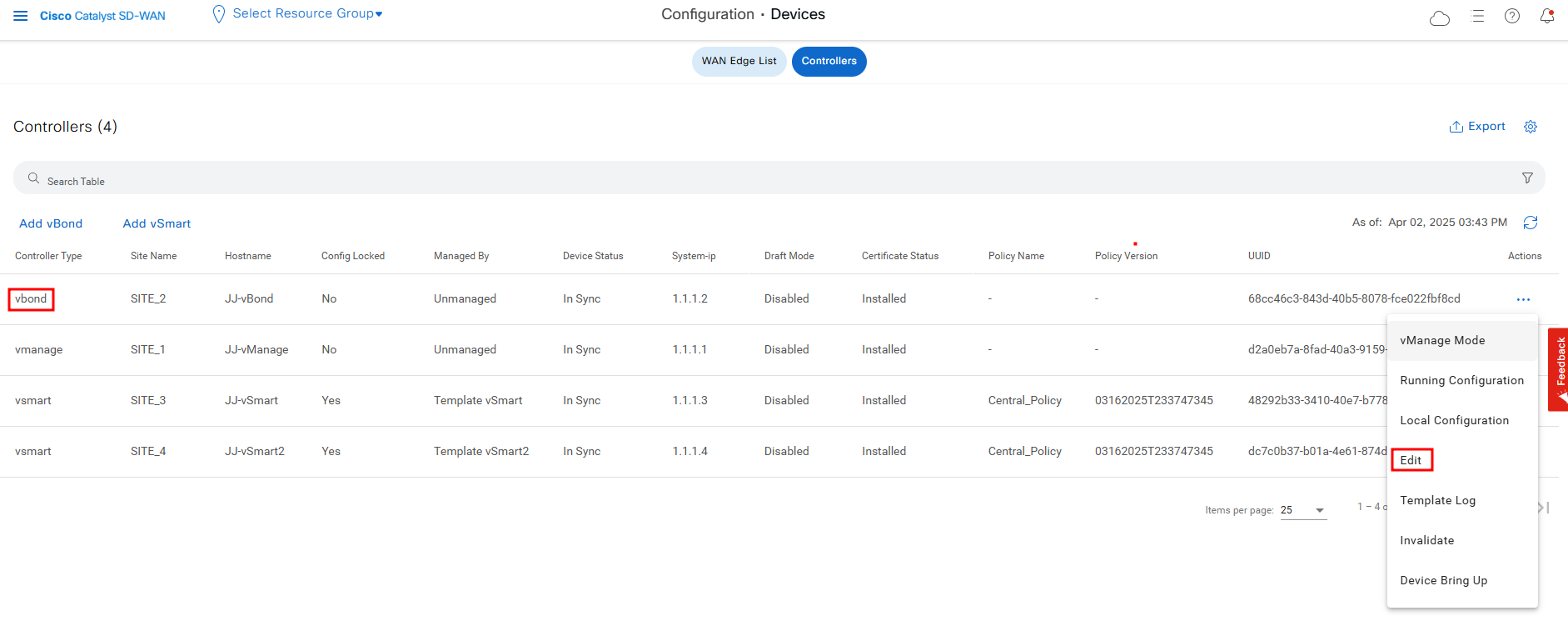

About step 8, Did you do below things ?
1. Navigate to Configuration > Devices > Controllers
2. Click "Edit" for vBond.
3. Fill the parameters.
4. Check whether vBond cert is signed automatically or not after 3.
