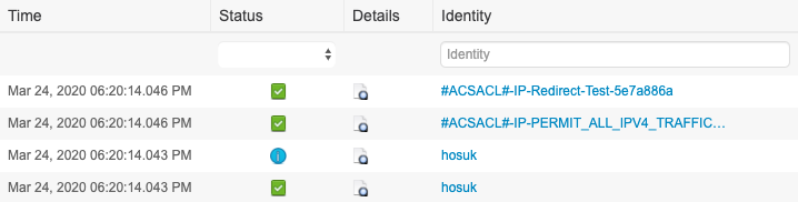

Result
Assuming both dACL and downloadable URL-Redirect ACL is applied, you will see authentication success followed by two ACL entries:
Also, the result section of the live log details will show the corresponding downloadable URL-Redirect ACL and dACL

Thank you for the guide!  "sh access-session..." output seems to indicate it works.  Now I just need to test it the next time I am onsite.  I do have a few notes.
1) It seems, at least in ISE 3.1, that the configuration audit log no longer provides the generation ID.
2) However, it also seems the generation ID is just the epoch time in seconds of the "Server Time" or "Logged Time" in the Audit Details table, so I was able to figure out the generation ID with a time format converter and the calculator method you provided.
Thank you, again!
_Nathan
Update:
On the Linux box I have available to me, the following command outputs the properly formatted version number, which I then append to the properly formatted ACL name preceded by a hyphen.
printf "%x\n" `date --date='<Server Time field value>' +%s`
i.e.
#$> printf "%x\n" `date --date='2023-05-19 16:21:23.462 -6:00' +%s`
6467f663
