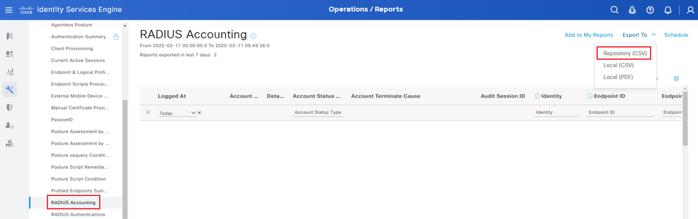

This Article draws attention to BUG ID - CSCwn63678 Radius Accounting reports unable export to the Repository ISE3.3, which occurs in ISE 3.3, such as RADIUS Accounting Reports (in Operations > Reports > Reports > RADIUS Accounting).
Description
In ISE 3.3, a 22-byte file (containing only the RADIUS Accounting "header") is generated when exporting a RADIUS Accounting Report to a Repository (CSV).
Another "reflection" of this same problem... RADIUS Accounting Report for the Last 7 Days appears empty:
Note: there are other symptoms... only the main ones have been highlighted here.
