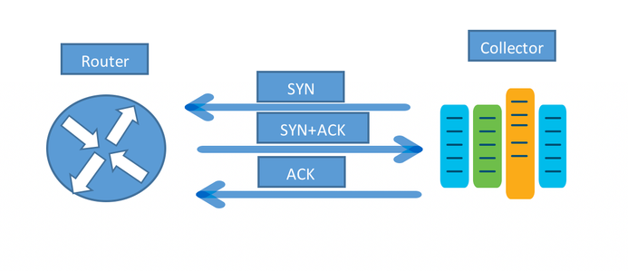

Dial In mode: Sensor paths and subscriptions are configured on the router. The collector establishes a session and subscribes dynamically to subscriptions on the router. The router streams data through the established session.

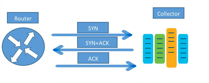

Dial out mode:  Sensor paths, destinations are configured and attached to one or more telemetry subscriptions. The router tries to establish a session every 1minute(based on the subscription) to each destination for each subscription. The data is then streamed out for each session according to the specified sample interval.

 In both Dial in and Dial out cases, data is streamed from the router.
