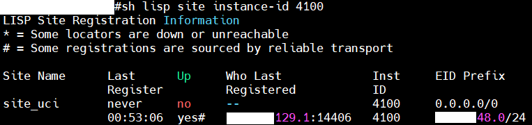

Can you send the output of "show lisp site" from a SDA transit attached border?
Do you have a site that functions as a en egress site for non-fabric traffic? (Can be checked under SDA Border configuration for the SD transit, there should be an option "This site provides internet access to other sites through SD-Access.")

Some outpus from Border DNA-Transit(remote fabric), CP and Border-exit-DNA(9500-VSS) below.
Addresses
BN DNA-Transit: x.x.129.2
CP: x.x.0.1 and x.x.0.2
BN-exit-DNA with checked option "site provides internet access to other sites through SD-Access": x.x.129.1
I checked with "sh lisp instance-id 4100 ipv4 statistics | sec Map-Register" on BN and CP an see a line like this on BN DNA-Transit:
Map-Register records in/out: 62/207
Not valid site eid prefix: 11
and this on CP:
Map-Register records in/out: 58/0
Not valid site eid prefix: 0
Border-exit-DNA:
Map-Register records in/out: 140/231
Not valid site eid prefix: 9

SS  = Service-ETR Firewall Service Insertion
P   = Primary/Direct in use, Backup not available
PB  = Primary/Direct in use, Backup available
B   = Backup in use, Primary/Direct not available
BP  = Backup in use, Primary/Direct available
MT  = Multisite Service Insertion
 * = This locator has multiple service EID configured.
LISP remote-locator-set default-etr-locator-set-ipv4 Information
 RLOC          Pri/Wgt/Metric     Inst       Domain-ID/MH-ID  ETR       SI/ID
 x.x.129.2   10/10 /0          4100       495636582/53350  Default   P /-
It's almost like someone has created a static route for 0/0 on 129.2 in the user VRF.
I think we need a TAC case or we need to take this offline, with diagrams, show runs, show vers, etc.
FYI this is what we should see on a BN that has no local internet access and is using remote internet over SD-Access Transit. Note the "B" which indicates we are seeking backup Internet over SD-Access Transit as opposed to a "P" which suggests there is local internet:
C-FIAB#show lisp remote-locator-set default-etrs

Hello Jerome,
our local dealer resolved the problem.
Between our sites we do static routing. From our Site 129.2 (which is connected via SDA Transit to 129.1, Main Site, with IP-Transit to external world) we have a default route 0.0.0.0 0.0.0.0 x.x.128.1
128.1 is on the same device which has the loopback address 129.1 (Main Site).
128.1 is the ip address of the interface who is connected to Site wich has the loopback 129.2.
The Device 129.2 has a physical address 128.2 which is connected do Main site 128.1.
On the Site with 129.2 we ca do a ping wich is successful to 129.1
The 129.2 Site has a default route to 128.1
The IP bindings via lisp from Site 129.2 to the TransitCP are all fine for default VN. But not for user created VN.
I do a few monitor sessions and saw that a ping from a user createt VN (Endpoint, PC) never leave the Edge Switch who the device is connected to.
I did a ping from another PC in the same VN which is connected via Main Site to Site connected via SD Transit. I saw packets came into Edge switch but never get back.
Solution:
The Edge Switch with loopback 129.2 need a dedicated host route to neighbour 129.1 like this:
#ip route x.x.129.1 255.255.255.255 x.x.128.1
[Remember, 128.1 has loopback0 with 129.1]
Thats all, the Client can communicate with each other and can leave via IP-Transit from Main Site the SDA Cloud.
Thanks for your help and have a nice weekend!
