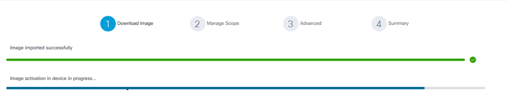

I'm trying to enable Embedded Wireless feature on a Catalyst 9300 that acts as a colocated Border & Control node.
I'm running the last version of DNA Center, 1.3.3.7
IOS-XE version on Catalyst 9300 - 16.12.3s
Same version for the Embedded Wireless Controller
On DNA Center, I go to Provision - Fabric, and click on the device I want to enable this feature.
Previously I enabled NETCONF feature on port 830.
Then I click on the check button to enable the Wireless Controller. In the next page DNA Center asks me to upload the image for the Wireless Controller, and this is the page (attached file) that I am stuck in, where I cant repeat the process or advance to the next option.
Any ideas on how to progress or repeat the process in a clean way again?
Thanks in advance.

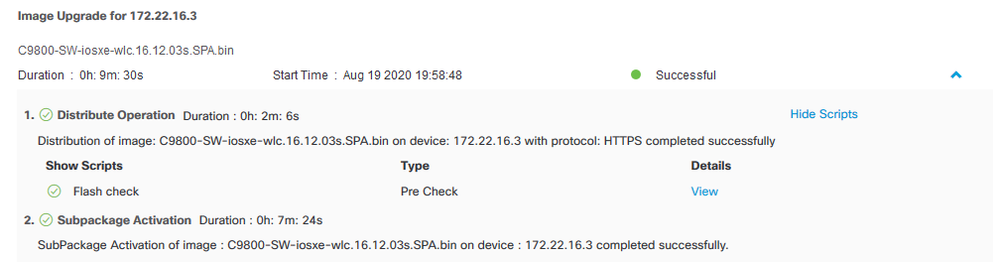

I have just deployed eWLC on a Border/CP Cat9300 node without any issues. DNAC version 1.3.3.6 with a Cat9300-24U running IOS-XE 16.12.03s. My DNAC is a minor version behind yours but I doubt version is the cause of the issue.
I used the following procedure:
  1. Enabled netconf-yang on the Cat9k and rediscovered in DNAC. Cat9k displayed (WLC Capable) in the inventory
  2. Toggled wireless to enable on the co-located Border/CP Cat9k under Fabric Infrastructure
  3. Uploaded the below image directly from my PC and selected 'Activate image after import'. As soon as DNAC imported the image, it moved straight to activation as below
Note that I did not upload the eWLC image to DNAC prior to the above
Image: C9800-SW-iosxe-wlc.16.12.03s.SPA.bin
If the image is not activating then I wonder if an error occurred during the install pre-check/distribution operation. Can you check 'Image Update Status' under Devices -> Inventory and see if the image distribution/activation tasks are listed and if any errors are reported such as flash check ? Screenshot from my DNAC below
Can you also try deleting the eWLC package from the DNAC image repository and try again following the above procedure and uploading the eWLC image when prompted after enabling wireless on your Border/CP?
Hi @willwetherman ,
Thank you very much for your information.
My switches are C9300-48U with DNA and Network advantage licenses. I've redone the discovery of both border & control nodes. Both with netconf-yang enabled. DNA-C detected both switches correctly with NETCONF available.
I've followed all your steps that were the same I did before. I've deleted the WLC package, and re-uploaded again.
It seems that the process has stuck on the same step, and each time I go to this page, it always shows the same. I attach it.
Whatever I do, it always shows this.
How could I revert this situation to the original state?
Thanks for all and regards
