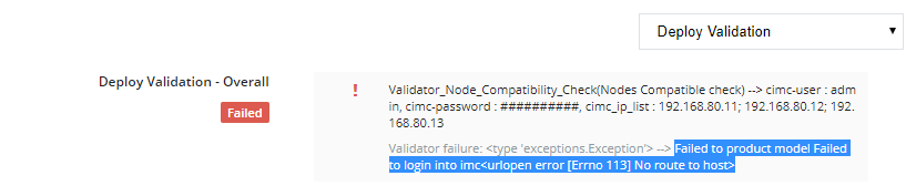

We are doing a Hyperflex Deployment for 2-Node Edge Cluster at our workplace.
When we are going through the Hyperflex installer wizard, it is asking for the IP details of the 3 Server nodes, but as it is a 2-node cluster we gave the CIMC IP details of 2-nodes which are reachable and third node we have to give the dummy IP.
But When Deploying, it is giving us an error in Deploy Validation. For Better understanding, I will attach the Exact error Screenshot below.
Please Help With the Error here. In the second Pic, Server 3 IP address is a dummy one and we only have 2 servers.
@dhamotharan please open a new thread if you have different issue.
What option did you pick at the beginning, on the 'general' tab?
There are two options, one is Hyperflex 'edge', and the other is 'Hyperflex with fabric interconnect'...
Can you confirm you chose Hyperflex 'edge' ?
Thanks,
Kirk...
