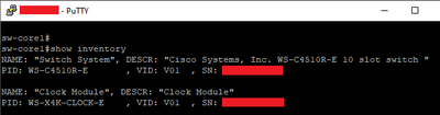

Hello. I would like to ask support with an issue I have.
I have a I have a WS-C4510R-E Switch implemented in the network. It runs version 12.2(54)SG1, RELEASE SOFTWARE (fc1) as seen in Figures 1 and 2.
Figure 1: show inventory
Figure 2: show version

Hey Leo. Thanks for the reply.
Yes. As you mention, the switch runs version 12.2(54)SG1, RELEASE SOFTWARE (fc1) as seen in Figure 2.
