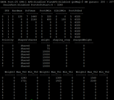

show interfaces gi x/x counter errors <<- share this
3800#show platform qos queue stats gigabitEthernet x/x
qos queue-softmax-multiplier 300 <<- add this and monitor the input error count ach 5 min.
Could you please explain how you read this?
I know the Queue 0 is for control and 1 is for data.
What is that Enqeue-TH1 and Enqeue-TH2?
TH0/TH1/TH2 these are the three drop threshold for queue'
If queue is full then the packet start to drop'
Some of these packet can be control packet and you face some issue in interface.
