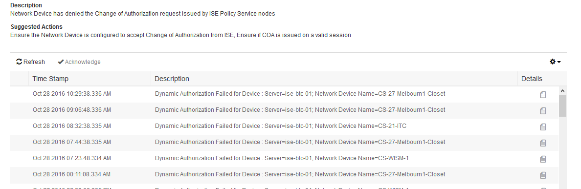

I am getting the Change of Authorization (CoA) Failed. Am getting this on all the switches configured for ISE

 Dynamic Authorization Failed for Device
