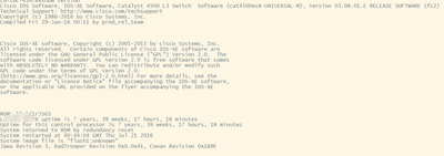

What firmware is the switch on and what is the uptime of the 4500?
