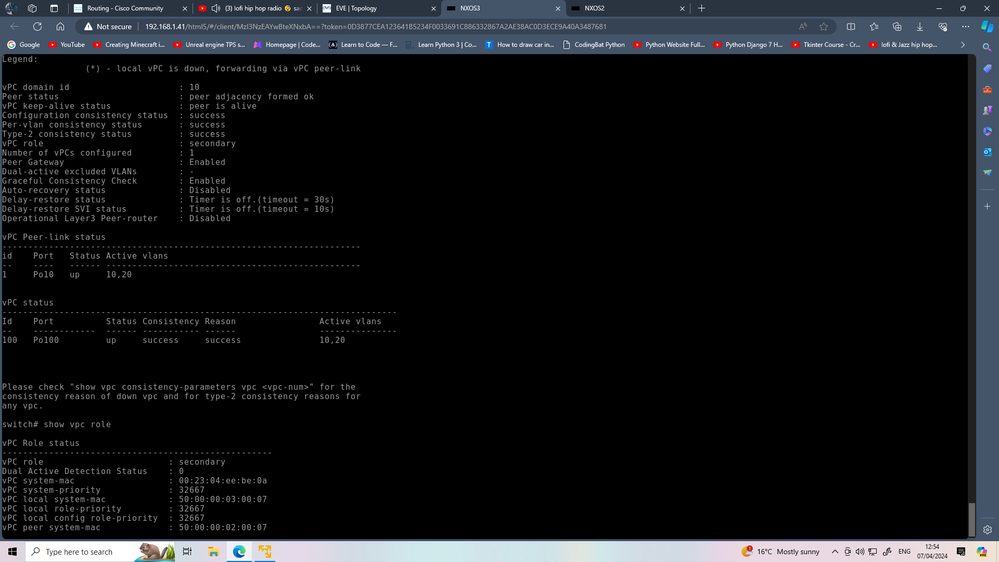

this Keepalive and Peer-link is UP

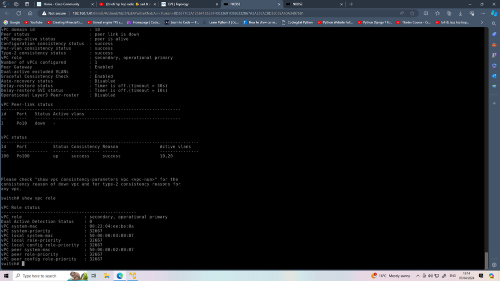

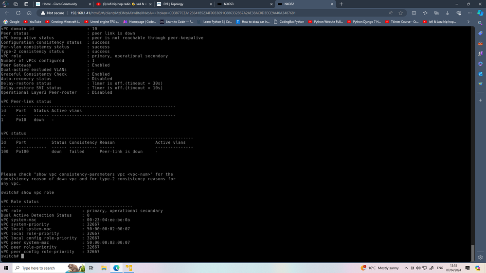

here we shut the peer-link
we see that the role of secondary is change to be operational primary
this called split brain now each NSK assume it primary of vPC

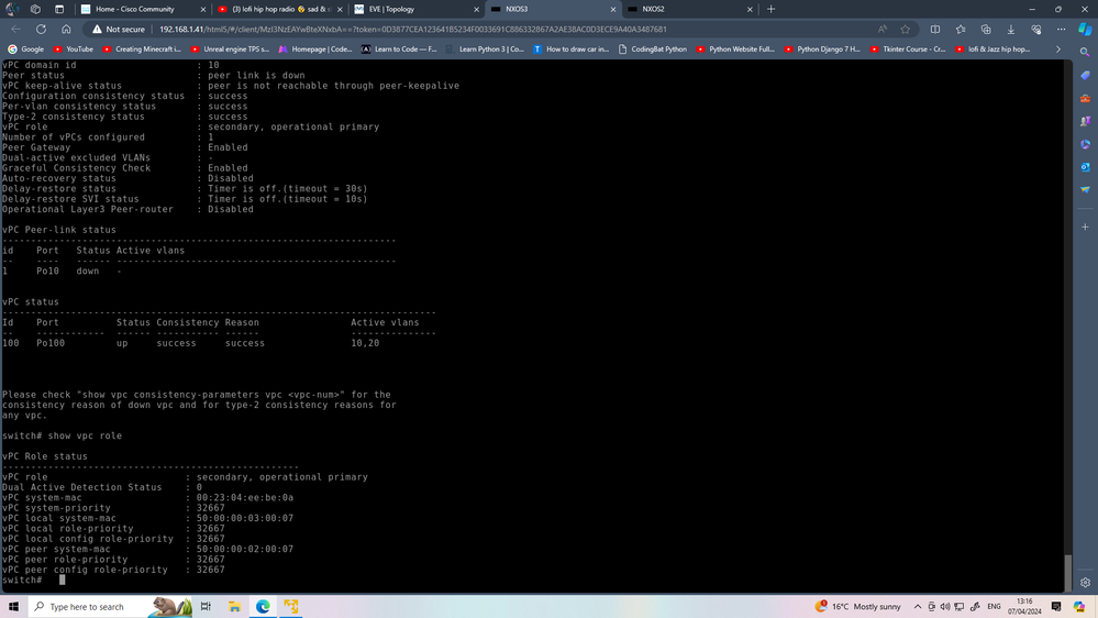

Lab 2
shut the Peer-link first then
shut the keepalive
here the difference between shut the keepalive first or shut the peer-link first
when we shut the peer-link first the Secondary (operational not admin) is show down all SVI interface for vPC-VLAN,
where in first example when we shut the keepalive this step not happened.
