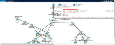

I don't know why I fail to load dhcp ip when I do dhcp related practice. Attached is the packet tracer file.
Villager
I tested base on your packet tracer file.
I remove the DHCP server pool . 10.3.1.0/24 network and 10.3.3.0/34,
after i remove and then I added new config as below. after that your dhcp is working fine.
I tested on your DHCP server can ping to PC Interconnected Router's interface ip. seen no network issue, That's why I change the DHCP server re-configuration.
Below for DHCP Test result
Cheer!

please share me, which server is dhcp server and which pc is client for DHCP. and then, we should find the root cause.
I marked the dhcp server, and all servers except the network on the lower right are clients for dhcp.
And there are no PCs as clients. I don't think servers can be dhcp clients in PT. Add some PC to layer 2 switches to see if they get IP from neighboring server. Don't forget enable and add networks on server
Update: Servers in PT can have dhcp IP - practice not recommended in real world.

I proceeded the same as the file of the newly attached packet tracer.
 However, in the practice of this file, servers are automatically assigned ip to dhcp, but my new practice does not automatically allocate ip.
Why can't I get assigned when I did the same thing? I wonder what you didn't do.
Click on those servers, go to config of Interface F0/0, change from static to dhcp.
What I posted saying no is this file. The file I posted just before is a successful file of the practice I followed.
Why does this file fail dhcp?

Villager
Cheer!
I didn't assign a subnet mask when I created the dhcp server pool. Your answer was helpful. Thank you.
Villager
I think, you forgot to add subnet. It's the problem of not getting ip from DHCP server and change .
