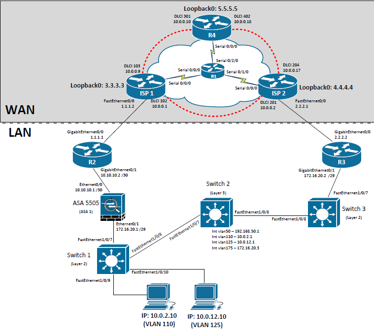

I'm having some issues getting an EIGRP design to work correctly. I've set up a lab consisting of a WAN and LAN. In the WAN portion I've created EIGRP AS 25. The WAN appears to work properly. I can ping all devices. I'm having issues with the LAN portion.
The goal I am trying to achieve is redundant WAN connections for the LAN. Because I'm creating all of this in the lab I don't know if it's my WAN not working correctly, or the LAN not working, or a little of both.
I would like the design to work as follows: Subnet 10.0.2.0/24 will always use R2 for Internet access. If R2 goes down, all traffic will route out R3. Subnet 10.0.12.0/24 will always use R3 for Internet access. If R3 goes down, all traffic will route out R2.
My test is to achieve a ping to 5.5.5.5 at the top of the WAN. I haven't been able to get it to work properly and I've confused myself with all of the troubleshooting I've been trying. At times I could ping 5.5.5.5 from 10.0.2.0/24 but it would route out R3. I tried increasing the delay on the R3 link to prefer the R2 route and that didn't work. I wanted to see if someone has some input. Much appreciated!

You need to look at PBR (and probably IP SLA) or VRFs to make this work. Because switch2 is the gateway for all clients that switch would need to support either of the above and it is dependant on the switch and the IOS feature set.
Because you want failover VRFs may not be the most suitable as they are primarily used for keeping traffic separate.

Yes policy-based routing seems to be part of the solution.  I've made progress.  EIGRP was a disaster.  I reworked all of the EIGRP configs and have the routing working correctly now.  All traffic is going out R2.  If I shutdown an interface on R2 all traffic will reroute out R3.
The layer 3 switch is a 3850 with IP services.  It supports PBR.  I've configured PBR on it and told it to set the next hop for subnet 10.0.12.0/24 to 172.16.20.2.  Although the traffic matches my access-list and route-map, it does not send the traffic out the correct way.  The traffic will only follow the gateway of last resort set by EIGRP.

I think I see the issue, now to troubleshoot:
SW2#ping 172.16.20.2 source vlan125
Type escape sequence to abort.
Sending 5, 100-byte ICMP Echos to 172.16.20.2, timeout is 2 seconds:
Packet sent with a source address of 10.0.12.1
Success rate is 0 percent (0/5)
SW2#ping 172.16.20.1 source vlan125
Sending 5, 100-byte ICMP Echos to 172.16.20.1, timeout is 2 seconds:
Success rate is 100 percent (5/5), round-trip min/avg/max = 1/2/9 ms
That's strange since I can failover R2 and everything will go out R3 when pinging from the workstation off of switch 1.

I ended up getting this to work.  I wanted to follow up in case anyone else needed this.  It's a little embarrassing why it wouldn't ping.  The R3 interface ended up being administratively shutdown.  I guess I had disabled it while testing and forgot to re-enable it before moving back to R2.
Policy-based routing was working properly to send the 10.0.12.0/24 traffic out R3.  The issue I had was that the traffic would drop once it hit the ISP2 router.  The issue was that I had not applied NAT to the R3 router.  Once I applied NAT on both R2 and R3 everything worked perfectly.
