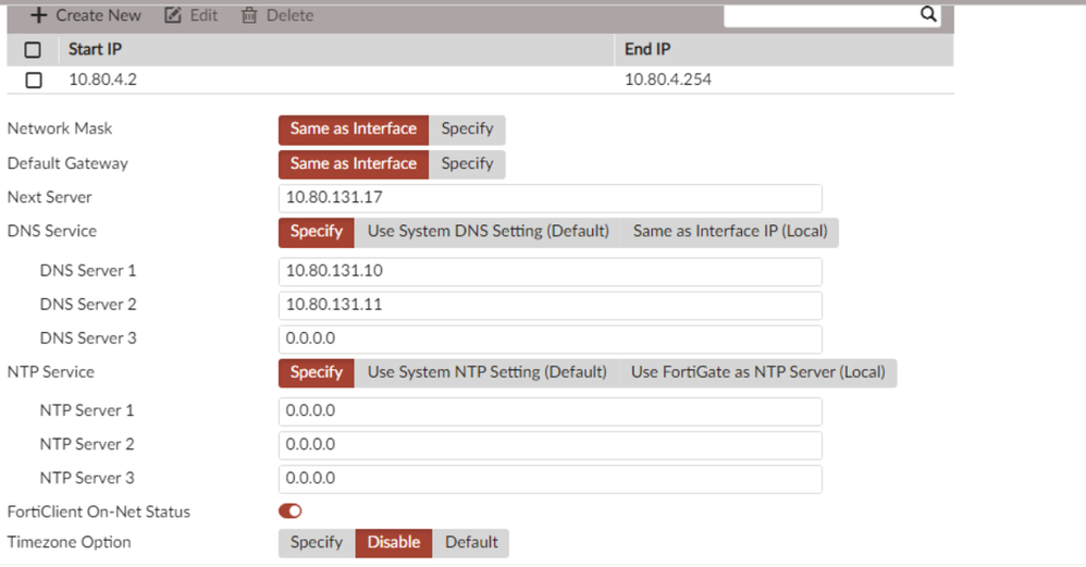

yes Fortigate provide NTP options when set up DHCP. But I've already allow ALL service destined for internet in FW policy.
As mentioned in the post, lapotops connected to the physical port 1 on FW works very well.
I compared the NTP settings between the VLAN type interface and physical port 1, they are the same.
and client from VLAN 404 can access the DNS servers listed below, I've already created the policy to allow the DNS traffic.
