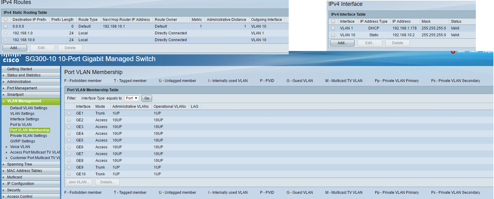

I purchased a Cisco SG300-10 managed switch in the hopes I could set it up where anything connected to ports 1-8 would be put in a different LAN than whatever is connected to the router. Basically, the router has an addressing scheme of 192.168.1.xxx and anything connected to the switch should have something like 192.168.10.xxx. Port 9 or 10 should be set as a trunk port attached to the router.
I'm not sure whether the solution involves a VLAN, DCHP server, or some combination thereof. The final setup should look something like the attached photo. The Desktop and Entertainment Goodies connected to the switch should be in a different local network than the Access Point and VPN Server connected directly to the router.
How do I configure the switch to put anything connected to it in a different network that the router provides?

I can't seem to find the VLAN setting that lets me set the IP address pool of a particular VID. I managed to create a VLAN with a VID of 10 and made the first eight ports members of it, but everything connected to it still has the addressing scheme assigned by the router.
I also found the setting to enable SSH and was able to login to the CLI of the switch, but sadly, I'm completely new to the Cisco set of commands and am unsure what specific commands to issue to make it look like your previous comment.
Any insight on where to go from here?

I couldn't get some of the commands to work exactly as what you pasted, but here's what I was able to input so far after looking up how to do some commands (hopefully it doesn't format horribly):
switch196f48#configure terminal
switch196f48(config)#interface vlan 10
switch196f48(config-if)#name Desktop_LAN
switch196f48(config-if)#exit
switch196f48(config)#exit
switch196f48#show vlan
Created by: D-Default, S-Static, G-GVRP, R-Radius Assigned VLAN, V-Voice VLAN
Vlan Name Tagged Ports UnTagged Ports Created by
1 1 gi1-10,Po1-8 V
10 Desktop_LAN S
switch196f48(config-if)#ip address 192.168.10.2 255.255.255.0
switch196f48(config-if)#no shut
switch196f48(config)#interface range gi1-10
switch196f48(config-if-range)#switchport access vlan 10
Port gi1: Port mode is not ACCESS.
Port gi2: Port mode is not ACCESS.
Port gi3: Port mode is not ACCESS.
Port gi4: Port mode is not ACCESS.
Port gi5: Port mode is not ACCESS.
Port gi6: Port mode is not ACCESS.
Port gi7: Port mode is not ACCESS.
Port gi8: Port mode is not ACCESS.
Port gi9: Port mode is not ACCESS.
Port gi10: Port mode is not ACCESS.
switch196f48(config-if-range)#exit
switch196f48(config)#interface range gi2-8
switch196f48(config-if-range)#switchport mode access
07-Dec-2016 18:57:26 %LINK-I-Up: Vlan 10
switch196f48(config-if-range)#spanning-tree portfast
switch196f48(config)#ip route 0.0.0.0 0.0.0.0 192.168.10.1
Now my web interface looks like the attached photo. I have my main desktop on port 1 and left it out of the configuration because the last time I set all the ports to "access" with the "switchport mode access" command, it locked me out of the switch and I had to a factory reset to get back to where it is now according to the above snippet and attached photo.
Currently, the desktop (switch port 1) has an internet connection and still has a local IP assigned by the router, and everything connected on ports 2-8 has no internet connection. It's also worth noting that my router is NOT a Cisco router, just the switch, so I can't access and configure it (the router) like the 2nd half of what you pasted.
Once it works and ports 2-8 have a different addressing scheme than the router, then I'll translate those settings over to port 1 as well.
I'm guessing the last steps involve setting a route from VLAN 10 to the router, but am not 100% sure. Where would I go from here?
Thanks for all your help by the way.

Sorry to cause so much trouble, but even after running that command, I can't seem to find a noticeable difference.
I hooked my laptop up directly to port 7 and it has no internet connectivity. The web configuration still looks like the photo from my most recent comment.
I'm not sure whether the problem now is related to a missing route or a bad port configuration, so I'm not entirely sure where to look now.

Edit: Thanks to (https://supportforums.cisco.com/discussion/12116176/rv042-082-016-sx300500-switch-open-discussion), I was able to setup VLAN10 the way I wanted. However, anything connected to ports assigned to VLAN 10 can't access the internet.
Maybe it's a missing route from the router to the switch. Is this something that needs to be fixed on the router's end or the switch's end?
