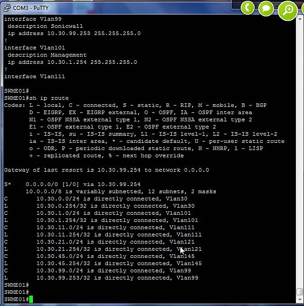

I'm at a loss here folks and really need some help.
Looking for some obvious things I may be overseeing?  Here is the situation quite simply.  Turning up a new site in Mexico to connect to our network.  They have their own carrier, modem, and we use one switch and a Sonicwall TZ215 with vpn tunnel.  I configured it all in the US here and shipped it down there with a console cable.  Now I'm finishing up some additional config. I'll post the config below.
Physical Layout:
Sonicwall XO  --> Port 24 on Cisco 2960-X
Avaya IP Appliance --> Port 22 on Cisco 2960-X
Test Laptop --> Port 2 on Cisco 2960-X
I had them down there plug in the Avaya (10.30.21.253) to port 22 because I need to access it and check its config.  The problem is, I can ping that IP from the switch itself, but from my laptop I can't ping it.  Nor can I ping it over the WAN here in the US.  The screwed up part is I can ping that gateway fine from any node on the network  (10.30.21.254).  I can also ping any of the vlan gateways ending in .245 on the switch. The tunnel networks work fine.
Now..if I put my laptop on vlan 121, I can ping the avaya appliance just fine.  On the vlan111 network, I cannot.  IP routing is enabled.  I've also got the correct return route configured on the sonicwall (if that matters in this test scenario)

Also, on the side, when I ping from a host for example, how does the traffic go..does it goto the sonicwall first because of the ip route statement, then the sonicwall returns the traffic back to the switch and the ping traffic to the host?  Or does local traffic not even traverse the sonicwall

I can't see anything obviously wrong with the switch configuration.
If you can ping it on the same vlan but not from another vlan it sounds like the Avaya does not have the correct default gateway.
Especially as you can ping the vlan 121 SVI IP from any device on any vlan.
Can you just run "sh ip int vlan 121" and make sure proxy arp is enabled ?
Jon

Hey Jon,
Here is the sh int vlan121 that you asked about.
SWME01#sh ip interface vlan 121
Vlan121 is up, line protocol is up

I just wanted to check proxy arp was enabled which it is.
So that must mean if you cannot connect to the Avaya from a different subnet on the 2960 that the Avaya has a gateway set but it is not from any of those subnets.
If it had no default gateway set then you should have been able to connect.
Unless it is not the Avaya's gateway that is the problem but from the symptoms you described it does sound that way.
Jon
So you were right...wrong gateway. changed it but still cant ping from 111...wtf...so odd
Also this is a newer 2960x in case that matters (config wise)
I did noticed that if I have port 22 (avaya appliance) configured for switchport voice vlan 121  I can't ping it from the host nor the switch itself. If I remove that and just make it switchport access vlan 121, pings works from the switch, but still can't ping from data vlan 111
NM, I figured it out!
Jon Marshall
By the way, I haven't done DHCP on IOS for a while but I think you might want to exclude the default gateway address you are handing out per pool.
Jon
Jon Marshall
Sorry I didn't answer your last question.
The default route on the 2960 will only be used for subnets not in the routing table.
If you mean when you ping between devices on different vlans but all these vlans are routed on the 2960 then no traffic doesn't have to go to the firewall  because the routing table on the switch will show all those subnets as locally connected.
Jon
