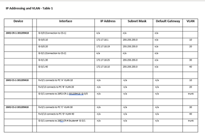

I am  trying to configure this, however, once I get to g0/0.20 and try to set up the IP address it tells me that 172.17.18.0 overlaps with g0/0.10 . What should I do?
Reza Sharifi
The message is correct because you can not assign 2 IPs from the same network segment to 2 different interfaces.
172.17.18.1/24 and 172.17.18.19/24 are both in the same /24 segment. Each interface needs to be in a different segment. Example:
172.17.18.1/25
172.17.18.129/25
HTH

Hello @olzhik,
Router route networks/subnets. You can not have same subnet/IP on differents router's interfaces.
Depend of what you want, you could use VRF in order to use same IP/subnet on the Router, but on a different VRFs.

"What should I do?"
Either change network address block allocations such that they do not overlap (all four IPs are all in the same network, 172.17.18.0/24, i.e. a /29 would work for each) or (as mentioned by M02@rt37) put each interface into a different VRF.
