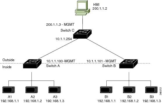

I found this example from the documentation of IE3300 Rugged Series switch:
So I guess there is no way to only use one layer 3 device to let the clients communicate with each other, am I right?
exactly. What it comes down to is that any layer 3 device will give you an error message and not allow you to put an IP address from the same subnet on two local interfaces. The example you posted has two switches as well, one for each inside/outside.
