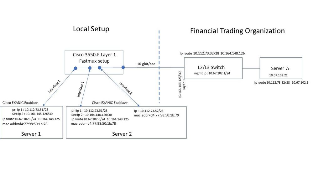

We have the layer1 setup shown in the picture.  We have Cisco 3550-F Layer 1 switch for the switch and EXANIC Exablaze as the server interfaces.
If we use only one interface in the server 1 and server 2,  and make these two interface ip and mac addresses exactly the same it looks that the setup is working. Ip packet returning from the Financial Organization  copied to all the downstream fastmux ports and related server takes care.
The other party organization forwards all the packets for our subnet by using a single L3 ip address  (10.164.148.126/30). Using a second or third interface in any server seems that this won't work because we can't set the ( 10.164.148.126/30 ) again. Is there a solution for using all the other Exanic interfaces in this setup.

Actually i realized that i didnt express the issue well . Some information that i gave here may lead some misunderstandings. So i redrawed the picture below.
We don't need to set primary IP's of the servers the same , primary IP's can be in the subnet range. We only need the set the /30 IP address ( 10.164.148.126 ) same . That's why we created the second ip interface and set this same IP address.
If we dont set any secondary IP for the other interfaces of Server 2, these other interfaces will be able to communicate through the first interface. This is something that we dont want.  As you may notice this time first interface will be a bottleneck.
