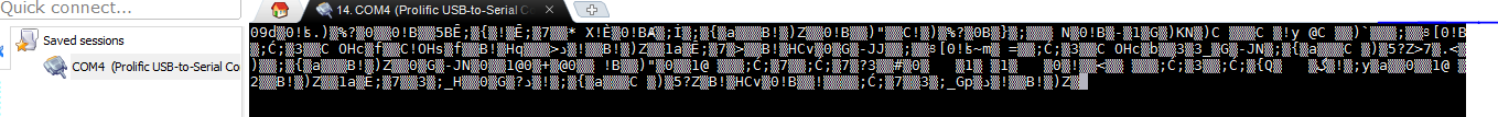

I can't go back to rommon 1 > mode
the consol is showing the below after using the "confreg"  and "reset" commands.
Please help
Try to change the baud speed. the default is 9600
http://digital.ni.com/public.nsf/allkb/D37754FFA24F7C3F86256706005B9BE7
I recommend to try with putty terminal software
http://www.putty.org/

Hello Julio,
The baud speed is already 9600
I have used Putty as well
Thanks, it works with baud speed 115200
