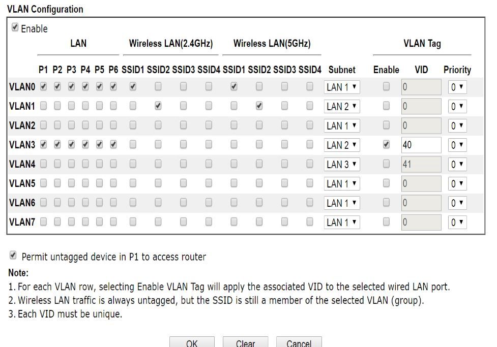

on Port 11 i have acces to the Managment Interface of the Accesspoint in the untagged Network (192.168.178.10), but no Access to the Tagged network (VLAN40) if i connect a "unmanaged" switch betwen the Router and the Accespoint, all works fine, the Cisco blocks the Traffic / dont send the traffic to him :( i have mor ports that have the same Problem
But i can Acces the VALN40 on Port 48, its configured as Static Acces to this VLAN.
Attached you see the Config of the Router and the Accespoint, this Config works the last 2 Years without the C2960S well...
On your first screenshot we see that ssid 2 is tagged but on 2nd screenshot there's no vlan 40 in vlan database.
This ap is a Cisco Ap? If so can you share the config on a text file?
Thanks
Francesco
PS: Please don't forget to rate and select as validated answer if this answered your question
Hay,
so the Router (second Image) has on VLAN3 the Config for the Tagged VLAN.
The System Works fine with an Unmanaged Netgear GS108 Switch. Only the Cisco switch dont pass the Data!
The Wireless Config from this Picture is only for the Integrated Wifi of the Router and dosent depends on this Wired Soulution / Problem.
The Cisco is Connected to Port 2, its on the Cisco the 1/0/17 Port. The Cisco Received the Tagged Data, i configure the Port 48 with Static Acces and get an IP and can communicate with this Subnet. So i think the Data are missing to the trunk ports

Ok let's forget the wireless. The router is the gateway on vlan 40.
If that's the case then the vlan id had to be the same. On the switch you used vlan 40 while in router you're saying that vlan tagged is vlan 3. Change this vlan by vlan 40.
Thanks
Francesco
Yes, its the Gateway on the VLAN with Tag 40 with IP 192.168.2.1 and also on the untagged VLAN with 192.168.178.1
The VLAN3 is in this case only the Configuration Slot, if you look in the rigth Table, you see that te packages are Tagged with 40, and it runs without Problems on the Switch with an Static Acess configured Port but not on the Trunk Ports
Ok you lost me.
What is connected to this trunk port?
On this device have you tagged the vlan id?
Can you do a span (monitor session) of that trunk port to validate that frames are tagged correctly?
