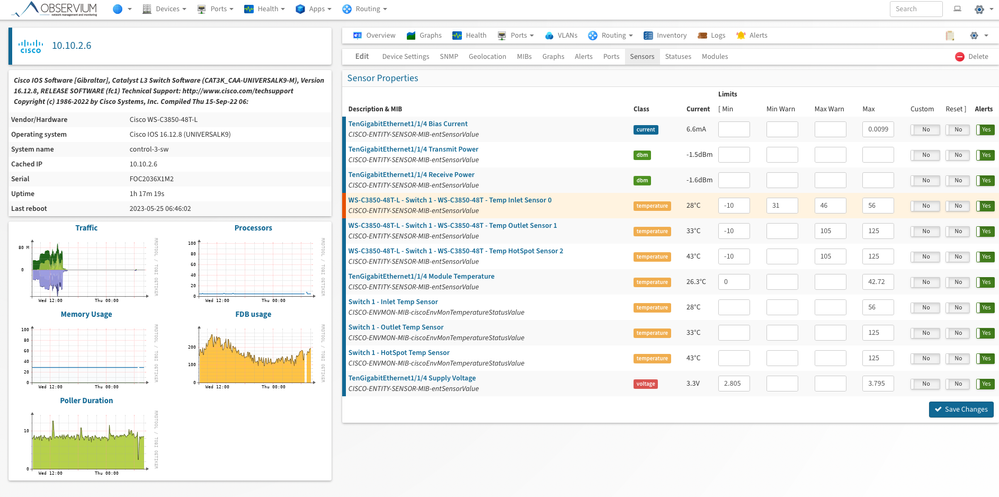

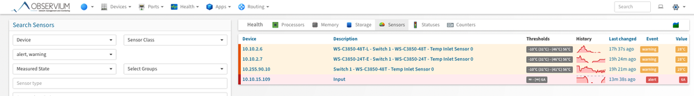

I'm monitoring with Observium and it's showing that the current temperature value is beyond the "Min Warn" value.
This value is being read from the devices.  (if I manually change them in the software they re-poll and return)

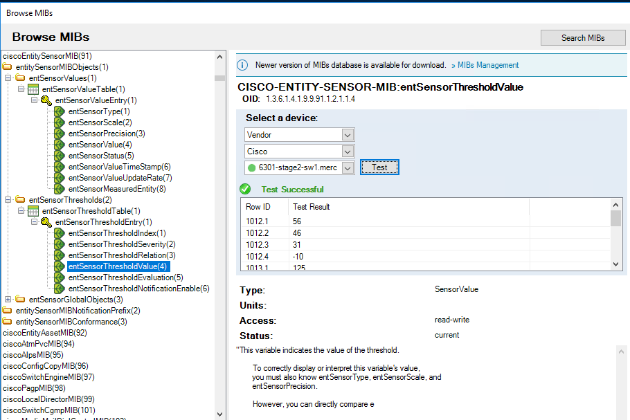

It appears that it's pulling the min value from OID 1.3.6.1.4.9.9.91.1.2.1.1.4 row 1012.3

Does anyone know where I can change that min warn value?  It's not appearing in the environment status.
