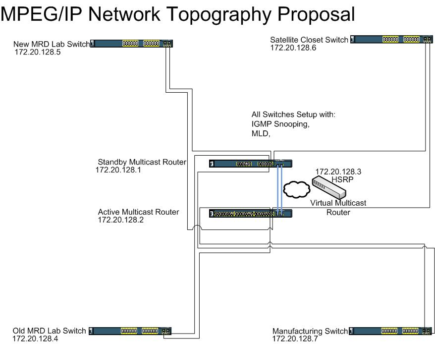

Thanks again for all of your help on this. I think maybe I had a skewed idea of how this was supposed to work. This switch is in a lab environment where any port could potentially have a receiver connected or a source. I am trying to get this setup so that I can be flexible and facilitate these scenarios. Right now I'm just trying to prove a proof of concept.
In saying that, how would I be able to test a proof of concept with just a single switch? Should I just put a group of ports on one VLAN (sources) and another group of ports on another VLAN (receivers)?
Is there any way to make this work within the same VLAN, because I have some devices that can send and receive multicasts simultaneously.
Eventually I will be turning this switch into strictly a multicast router with only other 2960 switches connected to it. I have attached what my plan is for our building. Do you see any problems with it?
